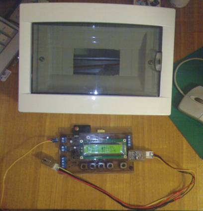

Much were written about this amazing " cubes ", has here is solved too to use given miraculously. Idea was such, support micro-climate  in cellar.
For conclusion of information is used MELT 2х line 16 class, keys of management with old motherboard 15N03H on 30 volts and ATMEGA 8 - 16PU.
Long hung around with code, on indicator were removed numerals, well even close not reminded true importance. What turned out to be, reasons 2, converter with 5 on 3,3 volts and recalculation itself got data.

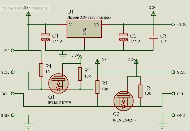

With first dared simply, there is worker of the decision from DECODER’а
http://we.easyelectronics.ru/part/datchik-temperatury-i-vlazhnosti-sht21.html :
With code it happened to to ask the help beside community, trivial errors from ignorance Bascom's, all we teach!
That was got.

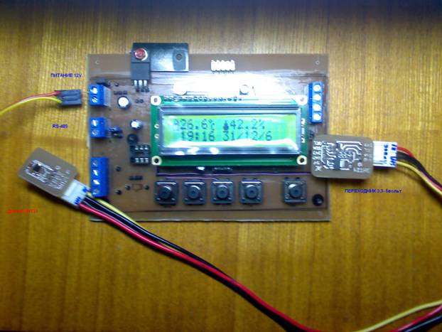

The First cut-in, call at in menu and choose the button upwards, downwards adjustment hours or limits of the functioning(working) the ventilator and heating. After striking IN- entering, all installed parameters are saved in memories MC. This 8 first cells to memories.
At achievement upper придела to moisture is included ventilator, but at reduction of the temperature - a heating.
The Ventilators use from BP computer, heater this Car heater sittings of the car. CHtob was a best return of the heat, glue her(it) on metallic the base 300*300 mm. If occurs change the ambiance, data and time, are sent on computer through RS-485.
The Disappearings of the feeding, in the same way оповещается through port RS-485. (if adapt autonomous feeding from telephone or simply battery on 4,5 volts.) Eats the block from 20 volts.
Certainly this not masterpiece, but works as it is necessary.
